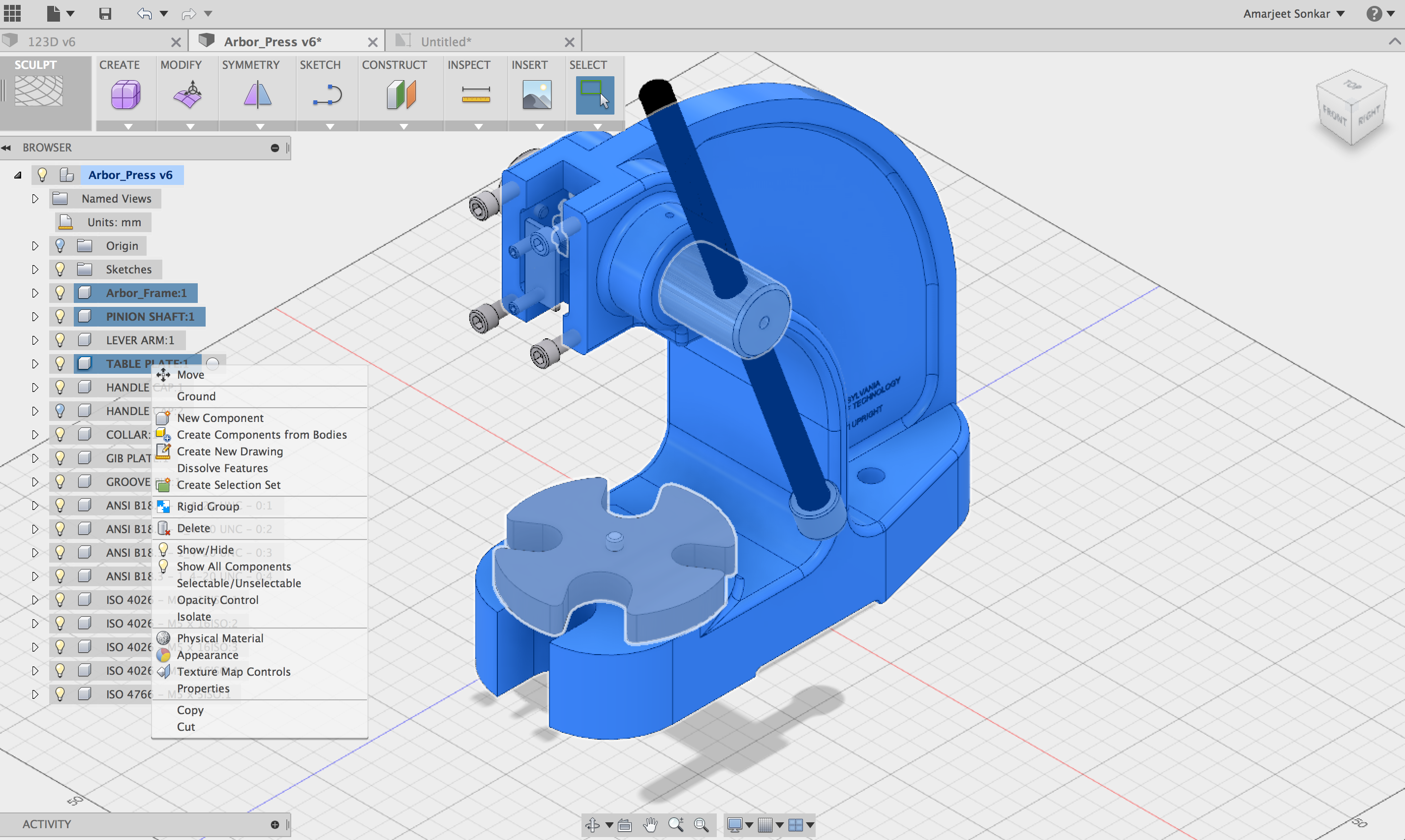

Here is typical workflow for creating drawing of selected components
1. Launch "New drawing from Design", in command dialog you will see Full Assembly is check marked by default, entire model is selected and prompt is displaying "Select to use full assembly, deselect to choose components."
2. Uncheck the Assembly option, and you will notice that nothing is selected from model and prompt is displaying "Select components to include in drawing". New option " Components" is available now in this dialog box, which indicates the number of selected components.
3. As you start selecting components from browser, you will notice number of components in command dialog is corresponding to selected component numbers, you can click on red cross (x) to clear the selection set  and restart selection process
4. When you click OK to create drawing, In the drawing you will see views of selected components only
Alterante way to create Drawing of selected components is to create selection set of components in Browser itself using Shift/Ctrl click and choose "Create New Drawing" from Right Click Menu.

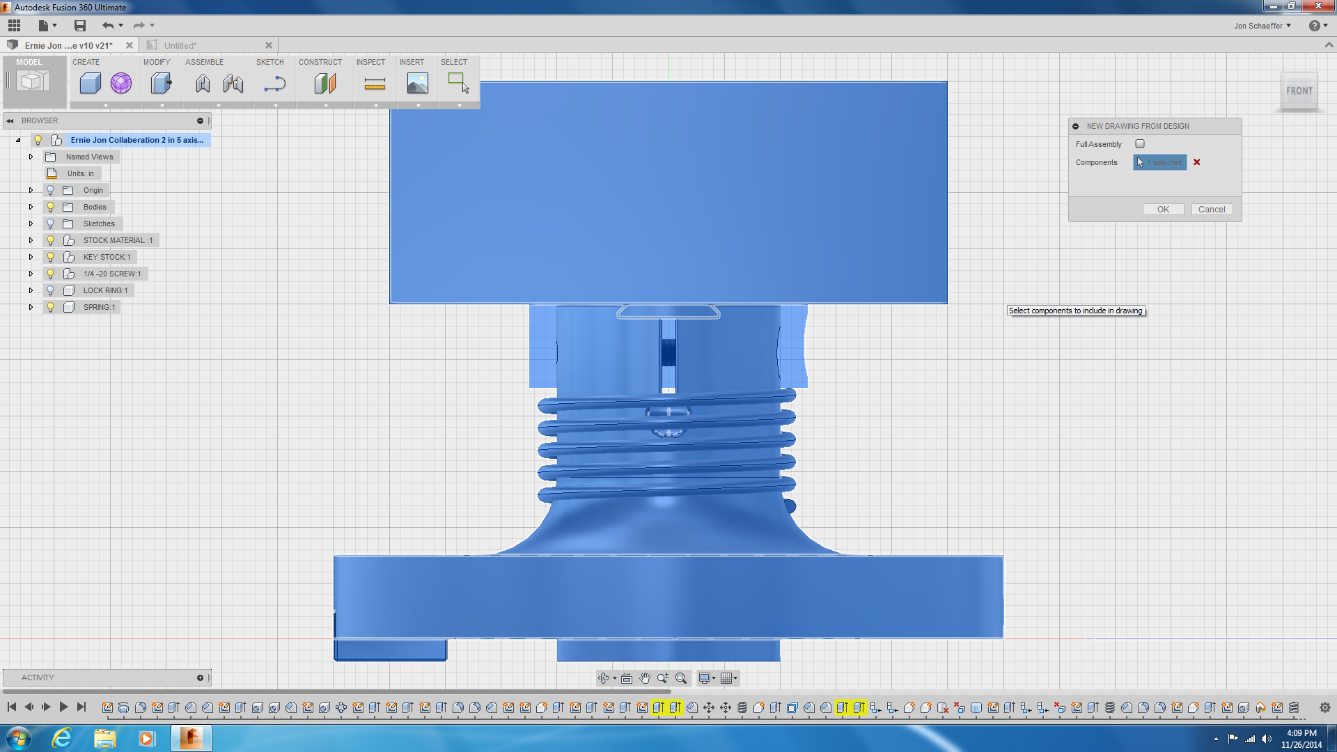

here is 2 screen shots of when I turn off a particular part, to make a drawing with out it, you can see it selects everything and then a more transparent re indroduced image of what I had shut off. then when I go to the drawing it actually still does print it like in the image #2 I show.
The images show out of order than I had planned. but here they are.

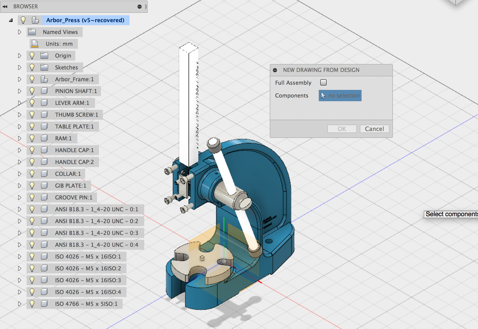

As I have mentioned in my previous reply, You need to select actual components from which you want to create drawing. From your posted screenshots, looks like you are trying to create drawing by selecting assembly in browser and expecting hidden component in browser will not participate in drawing.
Drawing creation is not restricted by visibility of components in browser, that means even a component is in hidden state (turned off), you can create drawing of it without changing it’s visibility state. Here are the screenshots for your reference,
Note: If selected component is in hidden state (turned off) in browser, after launching New Drawing from Design, ghost/transparent preview will be displayed for it.

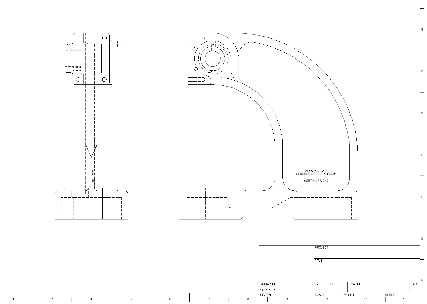

If you want to create drawing of full assembly excluding one or few components,  you must have to select all the components excluding those components which you don’t want to include in drawing. Here are the steps,
1. Launch New Drawing from Design and uncheck assembly check box. You can see "Components: no selection"  in dialog box
2. In browser, click on first component, hold SHIFT key and click on last component. All the components are selected now, and you can see number of selected components in dialog box
3. Hold Command Key [Mac] or Ctrl key [Windows] and click on components, which you don’t  want to participate in drawing. You should see reduced number of components in dialog box
4. When you click OK  button in dialog box, you will see excluded components are not visible in drawing views.
I hope this will resolve the issue and you will be able to create desired drawings.
