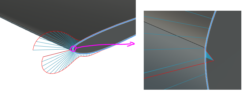

We took a closer look at this model, and my suspicions are correct:  The geometry here is the source of the problems with shell.  In addition to the areas that I pointed out above, there are also some problematic areas at the other end of the model:
If you zoom in on this area:
You can see that there is some weird extra edges there:
If you turn on curvature combs on this edge, you can see that the curvature of this tiny piece is radically different than the surrounding edges:
Also, if you turn on the curvature map, you can see that the curvature of this model is pretty uneven:
All of this adds up to challenges for the Shell feature.
As to why some thicknesses succeed and some fail, that really is just the nature of the shell algorithm, unfortunately.
So, what to do?  The problem is probably the imported IGES geometry is shaky.  Is there any way that you can re-model this wing in Fusion itself?
The other thing you can do is to fake the shell.  Create a solid body by patching the end, as you were doing, then copy that solid, scale it down, and subtract it from the larger one.  You won't end up with a completely uniform wall thickness, but it'll be close.  What are you planning to do with this model?  Is it OK if the thickness is not uniform?

I tried the curvature analysis and the whole wing came back green with bluey accents around the edge, but that was before I scaled the model down.  I just tried again and it does indeed look messy.  I did redo the body from IGES and carefully selected several faces that kept leaving themselves out, I also found that I could slice ot tip of the wing and then shell 95% of the wing as I wanted, and left a thicker shell at the tip before combining back again. that still leaves me with the same curvature.  The comb analysis certainly looks weird, but I really don't know how to interpret that.
