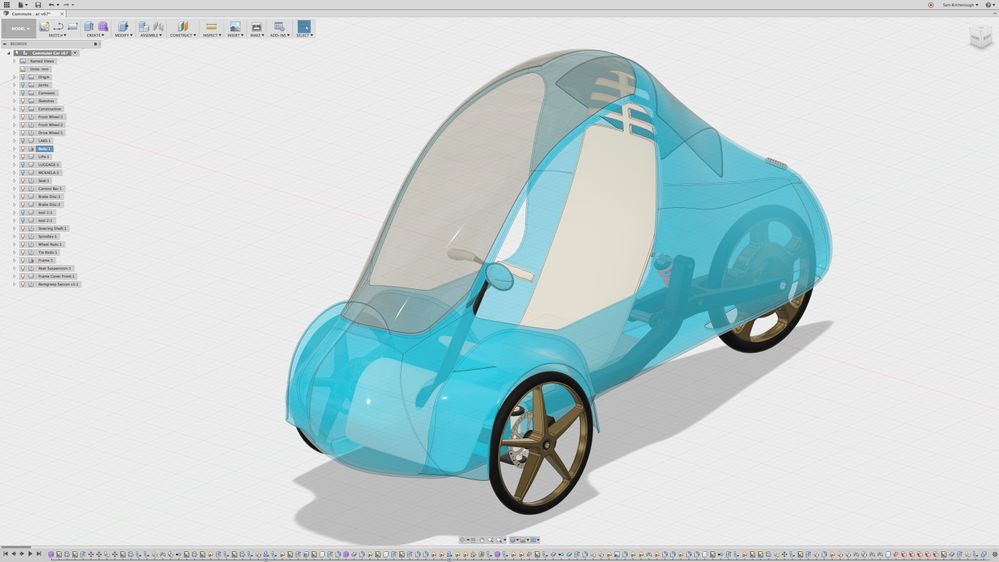

I'm so happy.
More complex model at high res graphics, no problems!
Looks like I'll keep the cMP for a few years!
