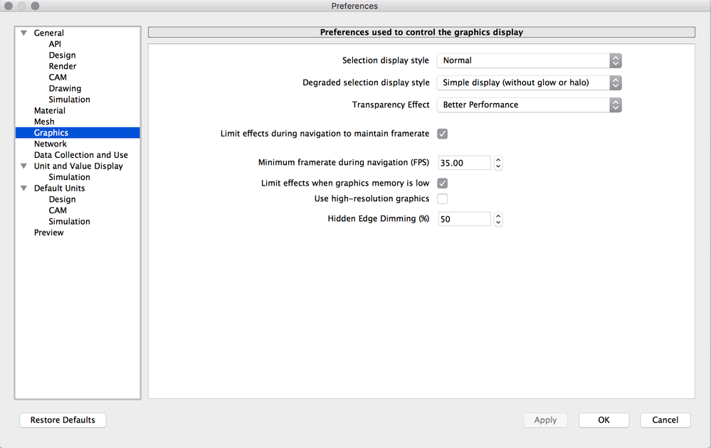

When Fusion detects the frame rate is not good enough, it will try to use the following logic to improve the performance during the navigation:
1. Degrade some visual effects(e.g., Ambient occlusion, ground shadow, etc) during the navigation
2. If the performance is still not good enough, then Fusion will not render the edges during the navigation
I think the reason for the poor navigation performance on this machine is your GPU card only has 2GB video memory but you have a relative high resolution display. To verify it, you can try to reduce the Fusion window size to see if it makes any difference. Another thing you can try is to switch to use OpenGL core profile driver by going to Fusion preference dialog->General tab->Graphics driver. Note: you need to restart Fusion to get the new driver to take effect.
Let me know if this helps.

Using the OpenGL Core Profile works! Thank you!!
With the graphics driver on "Auto-Select," even the smallest window size possible still has edges disappearing during navigation.
Is there a disadvantage to using the Core Profile driver? It does seem like the framerate isn't totally fluid all the time. Sounds like I need a better graphics card?
EDIT: Okay, whats event crazier is that the framerate seems better with "Use high-resolution graphics" checked. Maybe I'm imagining this though..
EDIT 2: Even with "limit effects when graphics memory is low," the framerate isn't too bad using the Core Profile driver!

Where is ""Use high-resolution graphics"" in the preferences ???

This option is only visible if you have a machine which supports Retina display. Otherwise you will not be able to see it.

I think it's only there if your screen is over a certain reso because it's not on my iMac (2560) but it is on my Mac Pro (4k).
Thank you so much for taking the time to test all that, I really appreciate it.
I'm testing complex models now and the edges remain visible with the Core Profile driver. I'm so happy!
