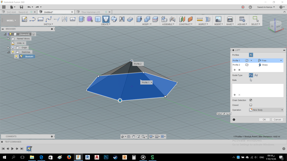

Oh sorry, I didn't notice that link you attached ...
Yes you can use loft to a point ( between polygon and point )
