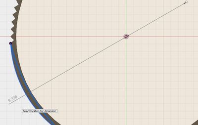

Message 16 of 17
I'm trying to do the Sketch Dimension part of your video, but it is taking the dimension from the center of the drawing instead of the two arcs.
Hopefully this makes sense.
Message 17 of 17
I actually got this to work properly and the result wad exactly what I was looking for. I wad missing holding down the shift key I believe. I think it just seemed more complicated at first because of the extra steps of the sketch dimension tool, but it really is fairly easy to accomplish and allows me to set particular parameters.
