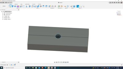

How do I get equal distance between the edges and the holes after creating a pattern?

Hi ,
make the first hole on the center of the shape
then make your pattern with symmetric
if they even numbers you need draw a sketch with dimensions
aliobidi
or you can start first hole near form the edge of the geometry and change " distance type " to " spacing "
but in this solution u need to know the length of this edge and make some math
chadN693J
Didn’t think of that. Thank you!!
