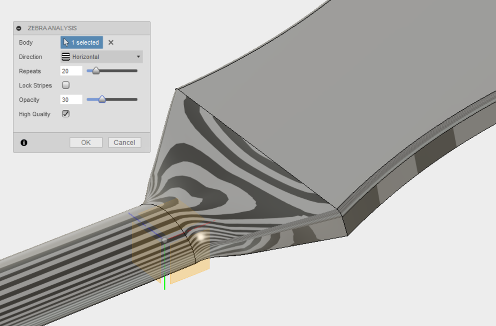

Hello All, I've re-worked the neck to headstock transition by adding additional guide lines as suggested by @cekuhnen to help with creating the curvature when performing the loft. I'm running into a problem now when trying to create a fillet and am getting an error message. I've attached a screenshot as well as the current file. Clauss, could you explain to me the meaning of G1, G2 that you referred to in your post? I'm assuming it's referring to the guidelines but I don't want to make an incorrect assumption. One other thing, when I performed the loft I lost two of the guidelines (one per side) that I had sketched. There should be a total of six but there are only four.

the fillet you try to do is incredibly hard because you fillet an edge to a point!!!
Look at my model you see that the there are edges of the head that are rounded and from those rounded edges
I further create / suggest G0 to G2 curves based on your need.
Also I can say it now officially but loft has G1 G2 for rails which will be very useful!
G0: two curves meet sharp
sharp transition
G1: an arc is tangent to a line
ok transition but in surface highlights you can see the surface patch edges
line instantly flows into arc
G2: a curve flows smoothly into another curve
highlights are smooth
one curve continues the flow of the other curve before bending
here this images illustrates it well
