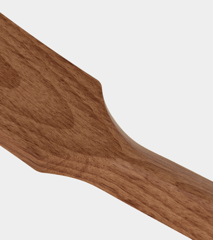

Hello Out there,
I've been working in the Sculpt environment on a guitar neck but ran into some issues and am now trying to design it in the  Patch environment. I'm actually hoping that I can get some of it done in Patch and then switch to Sculpt for the finishing touch's. I've been able to create the surface bodies for most of the neck and headstock but there is an area where they join that needs to transition smoothly and I don't know if it can be done in Patch. The area is on the underside of the neck where the headstock and neck meet (it's called a volute). How should I move forward from here? I've attached my file.

Is it something like this connection that you're trying to achieve?

oldtbone55
Hello Saed, yes, that is sort of what I'm trying to achieve. The transition has to be very smooth from the neck to the headstock. I've attached a screenshot of what it should look like. It seems that I have other issues with my sketches that are causing me to have problems.
