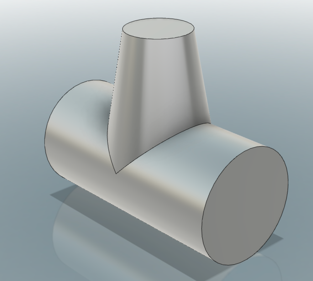

I'm trying to add 2 degrees draft to some parts for a mold.
When I select the parting plane and the solid it displays properly but the portion of the model disappears.
Really strange, I can't find it on any component in the model.
I have attached some pictures as I can't share the model.
Has anyone seen this behavior?

laughingcreek
this version seems to work, probably b/c you parted it into 2 halves.  I don't think it could figure out how to heal the geometry as it went around the bottom side of the tubes.  does create an overhang though.  might be ok if these are sprues.

TrippyLighting
Look at the attached model. Change the angle that I am pointing to and see what changes.
Then please explain how drafting works and why it does not in this case.
Hint: The picture alone can already explain that.

wmhazzard
@TrippyLighting I do not know what you mean but there is clearly something wrong, possibly a bug, with the draft command. The drafts fail when the bottom cylinder is split in half. When that is done, the top cylinder cannot have draft where the top is smaller, only larger. If I offset the bottom face by .002" I can get a successful draft, if I only offset the face by .001" I get a strange body on the bottom and the top disappears. Something seems to be off when the intersection of the top cylinder is coincident with the bottom face. Also the floating box that you can type the angle into is missing on my screen.

TrippyLighting
Cool test! I had not thought of that.
I think "the truth" in what is a real draft is somewhere between the geometry created by my file and by your file.
Both can be considered valid.
If you change the draft angle on both of our designs to something much steeper you can see the difference in geometry.
In your file the cone still is extruded from the base circle and intersects the horizontal cylinder, so in essence the surfaces of the cylinder and cone are not tangential.
In my file the cone surface will always be tangential to the horizontal cylinder (or so I think ).
The question is what would one consider to be the correct geometry ?
Both likely achieve the same goal and if you put a chord fillet on yours it'll look better.

wmhazzard
Technically your model would be correct in the real world. If you notched a piece of tapered tubing, you would get a cut like your model. That is the problem with the draft command, just picking a center plane may not be the correct thing to do in may applications.
I don't know what the OP's intent is but if that is a core and he needs draft for the core prints, I would draw it up like this instead, with the draft starting at the top of the horizontal tube.
