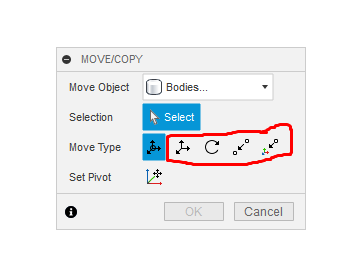

CargoFlyer777
Use the Translate option instead of free move in the move dialog box - it may take more than one move depending on what you are doing, but it does work parametrically 😁👍

Found this almost 7 years later.  As CargoFlyer777 indicates this will work if using the Translate option, but does not work with the free move.  This is not obvious from a users' perspective, but glad to see this was implemented.

laughingcreek
for bodies and faces, the move options other than the first one are parametric.
for components, by design they are positioned with  either joints, or by building"in place".  that's unlikely to be changing.

jrmhughes
Thank you!!   That's not obvious from the UI but I replaced my free move with a translate and a rotate which are working parametrically 😁.

jeff_strater
"EDIT: It works fine with bodies, not with components"
Yes, this is as intended.  No component moves of any kind (rotate, translate, free move, component drage) are "parametric".  Any component move just puts the design into a "capture pending" state.  You can use Capture Position to record it, but it will still not be parametric.  Body move, though, with translate and rotate ARE fully parametric.  I know you know this, just explaining in more detail for others.
