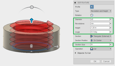

The thread function itself cannot be parameterized because it's controlled by drop-down selections; there's nowhere to enter in your parameters. However, you can definitely use a coil (Create > Coil) to make a custom thread that you can control with user parameters. It's more work in terms of setup, but if you want to make your nut as fully parametric as possible this will help. As shown in the pictures below, you can define the coil by revolution and height, by revolution and pitch, or by height and pitch.  The rough example I have below used revolution and height, and the external triangular section shape. You should be able to find charts listing measurements for your preferred thread sizes online.
Edit: I noticed that when I had a threaded hole (using the thread rather than the coil) and tried to change the hole diameter, the hole stayed the same size as well as the threads. Odd--I'll look into that!
