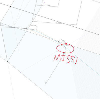

Ok, this is a mini-rant.
Please do not ask me to post files, they are all proprietary until I make a complete model to illustrate the problem.
Parametric modeling ALWAYS fails when using Conics or Splines. 2d and 3D sketches with conics and splines fail 100% of the time if any parameter is changed related to their positions.
I have basic parameters for an object that I need to fit around, so I have created the bounding box using parameters. These parameters are used to drive sketch dimensions. I create basic geometry and use conic curves for some of the corners to attempt to have some semblance of curvature continuity.
Basically, if I change ANY parameter, the sketch dimensions turn red and refuse to solve. The only solution is to delete the conic and re-sketch it. This, of course, is not acceptable as these are the control curves for lofts.
If there is anything with a tangent or curvature continuity in any sketch and and a parameter gets changed, the whole model fails to solve and requires a complete manual rebuild. I have noticed that all of the magical tutorials on the internet that show stuff like this working do not use conics or control point splines.
How am I supposed to make constraints so that parameters can be changed and still allow conics and control point splines to function properly?

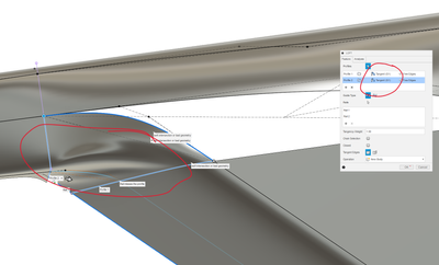

Ok, I've made a quasi-representative model that I can share. The object and the geometry are highly dumbed down. I don't have all the lofts super clean.
The inability to make surfaces curvature continuous is very frustrating, tangent barely works. As you already know, tangents are not curvature continuous. Also, the "curvature continuity" sketch constraint just about never works, and it only works fit point spline to fit point spline under certain specific conditions. Fit point splines are basically terrible when you're trying to accurately control geometry.
During sketching, if you try to constrain a point to a specific point on a conic, good luck, it almost never stays ON the conic.
If I were to make a similar model in 3DX or CATIA V5, none of this would be a problem. If either of those options were actually affordable for any company that is funded < $100M, that would be nice. The workflow and most features of Fusion 360 are generally great. The major challenges are that Fusion 360, Solidworks, etc. are all geared towards SOLID Models, and I need to make parts with composite layups. There is an add on program for Solidworks to do this, but it requires Solidworks Premium and is also cost prohibitive. I wish Autodesk had not dropped their composites tools, they looked pretty good from what I can gather from the old documentation.
Feel free to play around with the model. Change any OBJECT dimension and everything breaks. The geometry does not stay affixed to the points, a tangent constraint or dimension breaks everything. You absolutely cannot rely on geometry in another sketch and have anything work. Without relying on the other geometry, it is impossible to properly constrain everything. Also, it is impossible to constrain everything because Fusion complains "the sketch is over constrained". There needs to be a way to pull up a table of constraints in a sketch, this is super simple to do. Fusion creates hidden constraints that you cannot get rid of that are breaking everything. If 3DX or CATIA V5 does this, you can pull up the constraints and figure out what the problem is.
I understand this is the "budget" product from Autodesk, and they want to push Inventor, RevIT, and other tools - which are worse for my application than Fusion.
I have to re-annotate my screen captures, apparently Windows didn't save the annotations. I'll attach them 3 at a time in subsequent messages.
Thank you very much for listening and taking the time to have a look!
Patrick

dempseypj
Here are a bunch of screen captures, sorry, they are out of order in the preview window here and I can't drag them around....

I agree that the lofting approach needs to be improved, but that isn't the reason stuff is breaking and that is also very easy to determine.
As the OP suggested, changing the value of Object_W from the "default" 200 to 210, for example,  breaks the sketch "CS1".
Completely unrelated dimensions turn red, and the sketch and plenty of following sketches and features break.
I've spent well over an hour trying to create a "CS1" sketch that doesn't use any construction geometry and no projections, and then the sketch updated just fine. Unfortunately, I had to add some construction geometry and an intersection point between one of the construction lines and a conic curve. That intersection point is used later in the design; if deleted, other sketches fail.
And then, magically, that super clean sketch also breaks when the aforementioned parameter is changed!
Conics are buggy, and this is just one of them. Also, the false errors Fusion provided me with while deconstructing and reconstructing that one sketch are disheartening, to say the very least.
