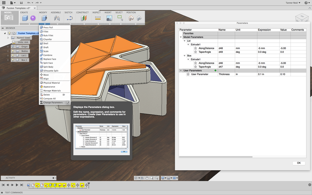

Hi there,
Have you looked at the parameters functionality in Fusion?  Under the model menu, at the very end, there's a tool called "Parameters", which brings up a spreadsheet of all of the values you've typed into certain sketches or features.
You can add named parameters by clicking on the Green +, and typing that name into a field in a sketch or feature.  You can also use the variable name of any of the past values you've typed in.  And changing the value of one of the variables in this chart will in turn update any geometry that references it.  This chart works across any geometry in your Fusion file (different components, sketches, construction planes, etc).

Hi there,
