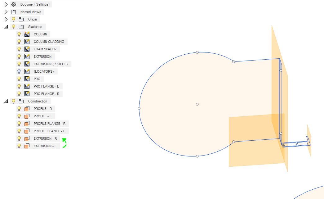

 Please consider bumping Browser organization/Layer recognition higher up on the list of things to work on. It really does make it difficult to navigate complex scenes and stay organized while continuing to evolve your design. The more stuff there is the harder it is to keep track of as is and that can add hours into production.
 I saw in the recommended thread above that "groups" were added to Bodies to help organize things and while it's considered "implemented," in the thread it's not entirely.
 We really do need a drag and drop feature similar to what pretty much every other software with layers has for organization (Photoshop is a great example), see attached for example.
 Another reason to look into this feature is if you edit older sketches they don't show new sketches in the browser because the new one wasn't created yet. (see example files 1,2,3,4). The only way to get around this is to delete work history, but depending on your workflow this could be a HUGE issue.
