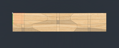

I'm unsure of the strategy to take to design a piece, similar to the picture attached. The different feet are all in different planes and flow into each other. I'm not experienced at all with t-splines but I imagine that is the way to go. Can someone confirm and maybe give some pointers.
Thanks in advance,
Kind regards

ruben_van_lerberghe
Thanks a lot, I had a look at those channels and also some basic modeling tutorials.
For this one I tried it with a box ( because I misread your first pointer, box instead of box view). When I try with as less geometry as possible this gives me some very bulky feet. I wonder if you would refine the legs after pulling them down or add edges before pulling the feet down..
I also have difficulty getting those feet to have a flat face, even with the option flatten.
I just add an image to show what I've "created"

TrippyLighting
If you can share the model, I might be able to demonstrate how to make edges more crisp.
You have two options. :
1. Add more edge loops
2. Creasing
Creasing allows you to quickly visualize what the final geometry will look like and where more detail is needed, but I usually avoid modeling with creases applied, or at least modifying those edges that have creases applied.
Creases, unfortunately, are all-or-nothing. A weighted crease tool as in some Sub-D modelers (Blender, for example), would be helpful.
Adding edge loops has other "problems" as it adds geometry and the more geometry you have to handle, the slower the modeling will become

ruben_van_lerberghe
thanks for your reply, I shared the model. Edge loops = insert edge ? I'd really like to be able to make the feet thin as in the picture in the first post.
Would you start from a plane or a box ?

TrippyLighting
Forst, I would encourage you to "play" with the form outside od such an already complex design. The form contains many N-Gons. I would avoid N-Gons and work with pure quad geometry.
I added some edge loops to define the feet better.
Then I cleaned up the model and created a pure quad topology, which was very easy to do.
