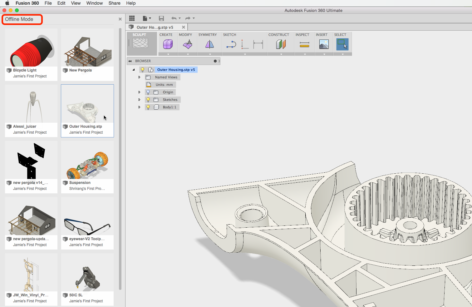

Hi Sandflo,
is there a  particular reason you want to open from your local drive?
Currently Fusion is a cloud based CAD/CAM system taking advantage of cloud storage and management of your data so you can always access it from any machine that has Fusion installed and so you are always up to date on the evolution of your designs and projects. We do not support the opening of files stored outside of the Fusion eco-system (i.e. your local documents storage).
There is a way to work offline and access your designs, but you will need to first open them while connected to the cloud.  Once you have opened a particular design we cache a copy locally that fusion can read and access while you do not have an internet connection.  You can work of your deisgn in offline mode, but will need to periodically connect to the cloud to ensure that your data is up to date within the connected system.
you can switch to offline under your user profile here:
As you can see, I have access to a number of designs that I've been working on over the past weeks and can continue to work on them.
you can continue to work off line, but I would connect to the internet periodically to make sure the data in the cloud is brought up to date with any offline work you've done; this happens automatically when you work online.  This will help keep your online data fresh if you ever access the data from outside of your main machine.
Also worth noting that any upload of new files needs to be done while online, as Fusion takes advantage of cloud enable translators to convert files into Fusion ready data.
let us know if you have any further questions.

Sandflo
Thank you for your quick responses.
The reason why i wanted to score files localy was when you work on a "secret" project for a customer, that don't want you to store it on the cloud.
