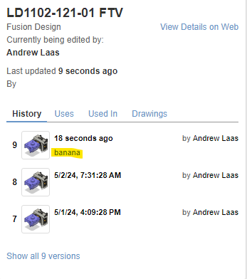

a.laasW8M6T
Hi Andrew
To avoid confusion I would not call a Design Document a Project
A Project is the Root level Folder containing design files etc(Documents) and other Folders
See here:
https://help.autodesk.com/view/fusion360/ENU/?guid=GUID-D28CA076-F78E-41FC-8F97-98F311B1D01C
It seems the OP is somehow getting Copies of the DESIGN rather than saving the same design, I'm not sure how that's happening accidentally, I have never seen any instances of this in my years of using Fusion
Changing the Version description doesn't do a Save as and make a copy it just ads the description here:
