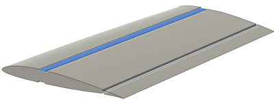

The wing was created as a loft with two profiles and two rails.
It also does not work as a reimported STEP.
It concerns 2 surfaces.
By the way, I have this problem more often.

wersy
There are even 3 offsets wrong.
The bottom of the slots are not all the way parallel to the outer surface.
Message 4 of 18
jhackney1972
Ok, you are talking about the Offset Faces, now I understand.  I see the issue now and I am not arguing that it is an issue.  You can get around it using an Offset Surface and Thicken Cut the area.  I only did one, to demonstrate.  Model attached.

wersy
Just now I see it, the offset has deformed the body.

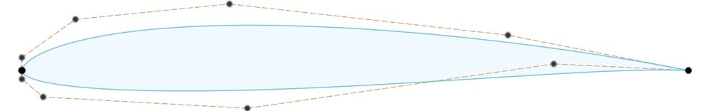

On the contrary, it is getting worse. Now all the slots deform the wing.
Previously I used a fit point spline from a .dat file.
This time I used control point splines with minimum number of points.

jeff_strater
Just a quick status update on this issue:  No real answers yet, other than to validate that there is a geometry issue caused by the Offset Faces tool here, and we are continuing to investigate it.  For a bit deeper bit of info on the result (not the cause):  What is happening in the failed areas is:  the modeler is collapsing what should be two vertices into one "tolerant vertex" that has a huge tolerance (3 mm).  In the image below, the red circle shows this collapse, while the green circle shows the correct results.  Very strange...
Jeff Strater
