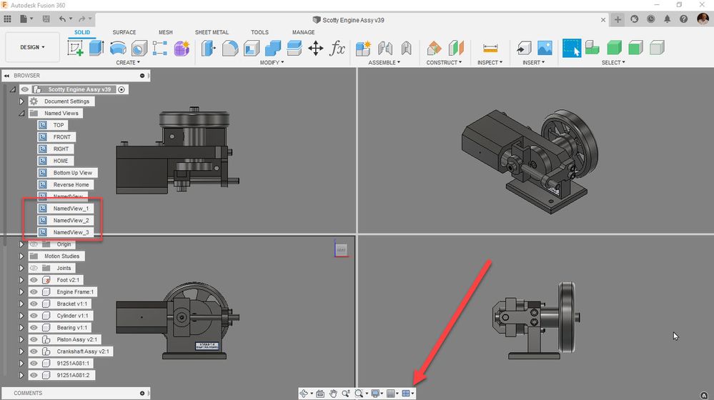

jhackney1972
I know it is no where near what you are proposing but have you played around with the Viewports option.  If you have setup numerous names views, you can assign them at random to the viewports and possibly get a little closer to what you are envisioning.

I think @davebYYPCU has a great idea with the Look At command.  You can create a "View Orientation Component" and place it into any assembly.  If you model using Standard View practice, the view orientation Component will come in at the same orientation to the assembly in any model.  You can then use it to assign views using the Look At command.  The view orientation component can be any number of standard angle view faces, mine was eight sided.  Screencast will explain its use.
