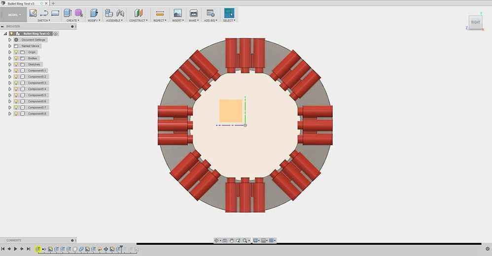

Not sure.  I managed to get to this point.
I THINK what I did was create an extruded circle, aligned the red component with the outside of the circle (I couldn't figure out how to do a coincident alignment, but the one that worked ended up being what I wanted).  Then I created a circle pattern using the outside of the extruded circle as the axis.
I'm marginally confident that I could repeat this.  I've been trying to reproduce my happy accident with no joy thus far.
Whenever I want to try to move one or all of the red items I have to select zillions of items.  Is there a way to conenose, coalesce  or group items into one thing that's easier to select?  I feel like every time I want to pick up a book I have to do so page by page by page by page by......

Ahreum...I think I might actually be making some progress.  I think I have the base item set and am actually going to try to machine it today.  That's another whole learning curve as I barely know how to turn the CNC on...
I just shared the file with you.  I think my only issue right now is that in creating the circular pattern I ended up with 64 components that I could not group into a single component.  I think the issue is that my timeline marker was not at the end of the timeline. I right clicked the desktop and (did something) to tell F360 to ignore anything after this point.  Then I was able to drag and drop all that junk into one component.  Deal.
But, that method then destroys anything that was done after that point correct?  So it looks like if you don't stay organized along the way there is no non-destructive way to organize later.  Am I reading that right?
I'm also attaching the notes to self I made along the way.
