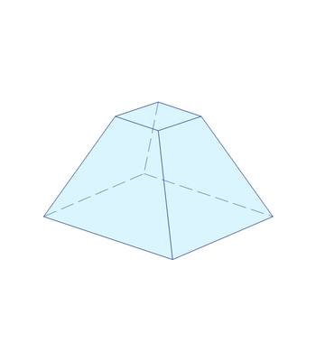

I'm new to Fusion 360 but have some experience with other more mundane 3d packages. I want to make a pyramid that has a flat top with two conditions I can't figure out:
- I want the angle of the base going upwards to have a specific angle (most important)
- I want to be able to set the height of the pyramid (less important
Does anybody have any tips for a new user?
Example of such a pyramid:

Message 2 of 12
davebYYPCU
On the basis that you know those particulars,
use Extrude for the square, with (known) taper angle, the height as you wish.
Might help....

Thanks for your reply! It doesn't quite work the way I expected it would.
I get the below:
While I am looking for a 76 angle on the slope like:
More ideas are welcome 🙂
Message 4 of 12
HughesTooling
Have you tried setting the taper to 90°-76°? So 14° taper.
Mark
Mark Hughes
Owner, Hughes Tooling
Message 5 of 12
davebYYPCU
Use -14 degrees.
90 - 76 = 14.
Message 6 of 12
Ah, totally wrong logic. Thanks a lot!
