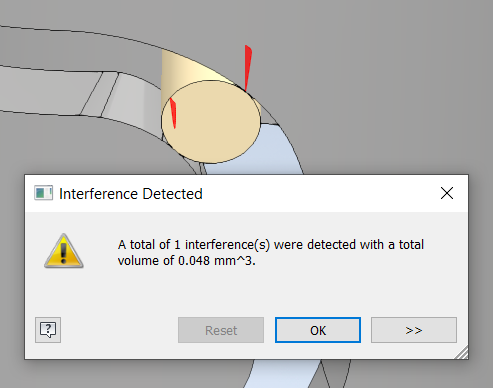

TheCADWhisperer
I edited your Sketch4 to enter a precise size of 10mm.
Then I placed the part in Autodesk Inventor with a Transitional Constraint between  a Ø10 pin and the slot.
I am seeing interference at various locations along the slot.
@davemooreracing
Imagine this cylinder is the cutter that cuts the slot.  The tangent contact is continuously variable along the length of the slot. In the process of cutting the slot - the red interference shown in image would be removed by the cutter.
Then in you mechanism a slightly smaller diameter follower pin will smoothly follow the slot.
Notice in the image below that the continuously variable tangent location has moved.
But when the cutter tangents are at 6 and 12 o'clock or 3 and 9 o'clock there is no interference.
This example is pretty close to correct, so the interference is relatively minor, but I think we can get a solution that is closer to Sweep-Cut of a solid body (the "cutter" cylinder translating up/down while the cylindrical cam rotates).
Message 18 of 42
michallach81
I would blame interference detection accuracy which must relay on the tessellated model to run calculations. Maybe there is a tool in Inventor like in F360 the DISPLAY DETAIL CONTROL. If there is such setting it to HIGH level should decrease the size of interference. It is less likely that it's caused by inaccuracies of modeling kernel. In principle this method work as long as we driving a cylindrical pin (or a drill/mill).
