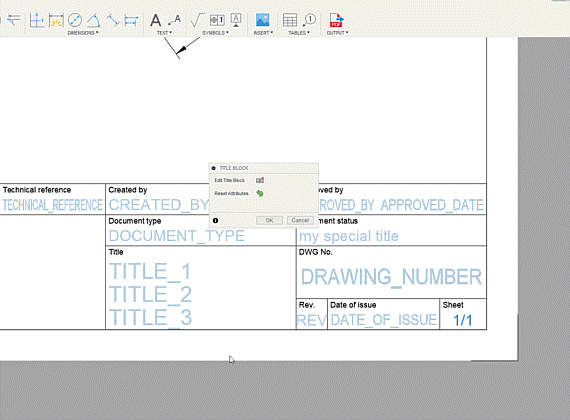

How do you get the custom attributes to work in the new title block? The built in ones work fine, but the custom ones I made are not working. When I double click the title block, it just takes me back to edit mode. Where do I put in the info?

carl.j.barker
Double click the title block as before, Don't touch the POP-UP window. Then just click any blue text to enter or edit it. Then click OK on the pop up.
Message 3 of 18
TPrice_71
Perfect! Thank you for your help!

g-andresen
try:
1. if you want to enter data:
2. change attribut and edit:
change attribut  & editchange attribut & edit
günther
