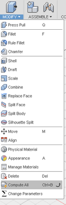

I have a couple of suggestions you could try to fix this:
1. In the Design, run 'Compute All' from the Modify Panel menu, save and try to create a new drawing / update the existing drawing:
