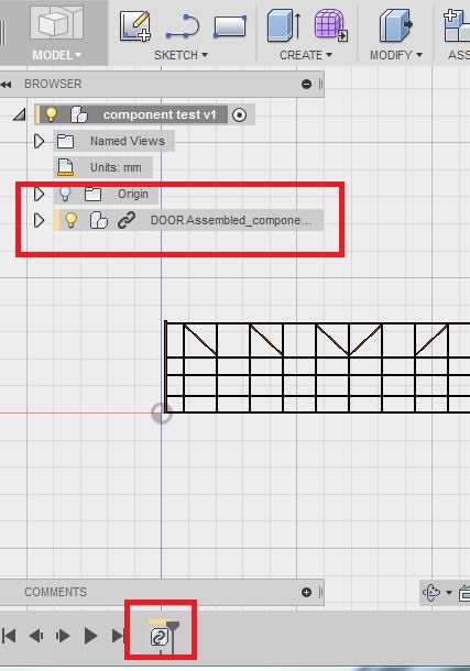

i have a bunch of components assembled into one large component.
now that i have that compnenthow iwant it,isthere a way tosave it as one big component? instead of each individual one?
it would clean up my timeline andbrowser,andithink speed up assembling it into the other large component thatwill be the other part to an assembly.
im not planning to edit this,andi wouldthinkif i needed to i couldjsut go back tothe asembly it was created from,editthat,then get latest. ormaybe i dont understand how that works.

Hi @dieselguy65,
Thank you for posting this! If you insert the file "Door Assembled_components" to another design for larger assembly, it will collapse the browser and timeline. Does this work for you?

I'll give that a try this afternoon. Not sure it wIll accomplish what I'm after. Right now, when I take this large assembly made up of 40 or so components, and try to place it in the main assembly, the software basically freezes. I think it's just overwhelmed with the parts, and all the different axis they are in. I think I may even try, to just make a new component, with the outside shape of this part, and eliminate all the interior pieces, that should give the software an easier time. But I really hate that idea
