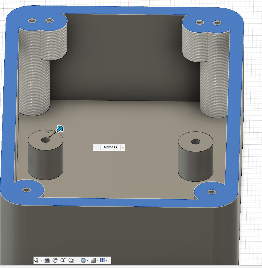

Howdy,
I am trying to make a box that holds a circuit board inside it and has screw holes for mounting a lid. I have the screw holes for mounting the lid just fine, the problem is I need to lower the mounting holes to the bottom of the box. Attached is a screenshot. I need to lower the interior ones to the bottom so I can mount the board to those lowered holes and close the lid without crushing anything. I am brand new to fusion 360, so any advice you give me I will need to have explained fully, please.
Thanks for any and all help
1,346 Views
wmhazzard
Start by deleting all of the threads. Then delete the posts that are too high. Then make a sketch on the floor of the box for your posts and then extrude up the amount that you need.
TheCADWhisperer
File>Export to your local drive and then Attach your *.f3d file here.
etfrench
Use the Extrude or the Press/Pull command to move the top face of the posts.
As @TheCADWhisperer says, attach your file to the thread for more comprehensive help.
ETFrench
I think I have found some way to get it working. I am basically making them the same height as the other ones and then using the press/pull command to shorten them to the height I need. Thanks everyone for the help
