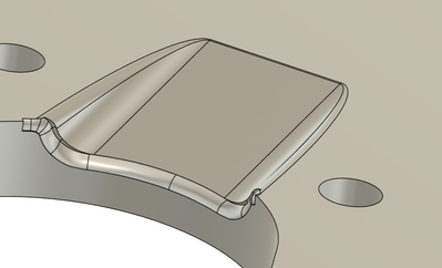

I want to make a fillet of radius 5mm to this part from the arrows in the picture. But i cant´t.
how to fix it?

These edges are continuous, so you need to fillet them all:

Hi! I believe this a filleting sequence issue. You may want to move the timeline bar to the left of Fillet1. Then create the 5mm fillet. Move the timeline bar back. Fillet2 may fail. You may edit Fillet2 and reselect the desirable edges.

I only want fillet between the arrows in the picture.

maskinNKTMA
Hi
I want a fillet on the edge of the big radius between the selected areas.

Only this area cannot be fillet.
It would be something like this.

Just like that beside it looks strange in the star/end. How to do it?

Alternative solution:
