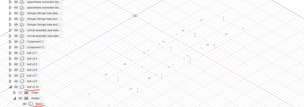

I am trying to run a static analysis on a school project but whenever I try to use fusion's analysis tool the simulation fails and gives this error message:
with the suggestions:
However, I've checked my model and it seems like everything is properly constrained. In addition, the precheck tool is showing that there isn't any errors so I'm honestly confused as to what could be causing this? I've also verified that the mesh is working properly before solving so I'm pretty sure it isn't something with that.

Hello @gsl58 :   The problem that you are encountering is due to not-recommended modelling practices.  For example, the body "bolt v2:16" is modelled as a single body but contains multiple bodies:image1.PNG
Some bodies or lumps in Body1 of bolt v2:16 are not connected at all, making the solver fail, for example:
image2.PNGWe strongly recommend modelling each body independently (instead of lumping them into a "single body") and then define the appropriate contact conditions.  The assembly contains several cases like the one described above.  A simple interference check in the simplify environment reveals that many bodies are interfering with each other, which is an indicator of lack of proper contact between components in the assembly, for example:  image (17).png
