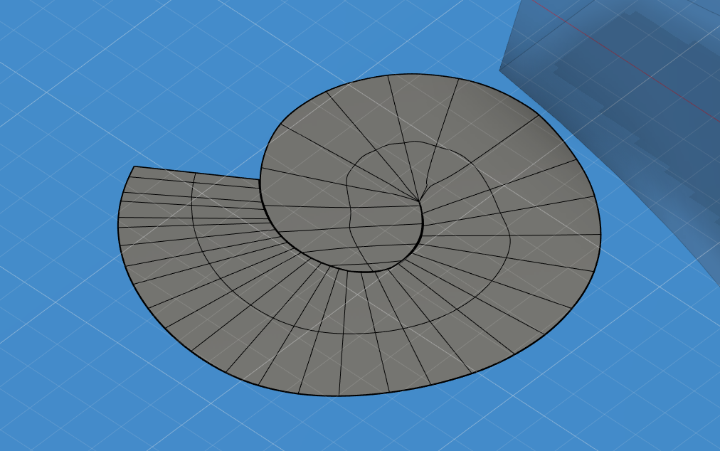

Wow! Okay so I was using WAY too many polygons. The way you showed the sketch was suuuuper helpful, I was basically just guessing where I would like the polygons but spiralling some lines out to pre-make where you want to put the faces is so helpful.
It's too bad that the program seems to ignore where I want the spiral to end up. I can see it is basically averaging where all the points lie and pulling them in but it's not what I want. It seems like T-splines are super useful when making something abstract with no real correct answer but when I want to fit it to a pre-made sketch is when it starts giving me trouble. That is why I ended up using so many polygons in the first place so that the outside would line up with my sketch. I think I'm gonna move away from using T-splines since it doesn't seem to fit what I'm wanting.
I have attached some pictures of me trying it out and you can see smooth mode is not touching the sketch anymore.

While I do think much of that "pulling away" can be dealt with with further modeling, I also think that working with surfaces and lofting will get you the shape you're looking for. But, again, I can only vaguely guess what you are looking for, which makes it difficult to give any recommendations on how to proceed.
