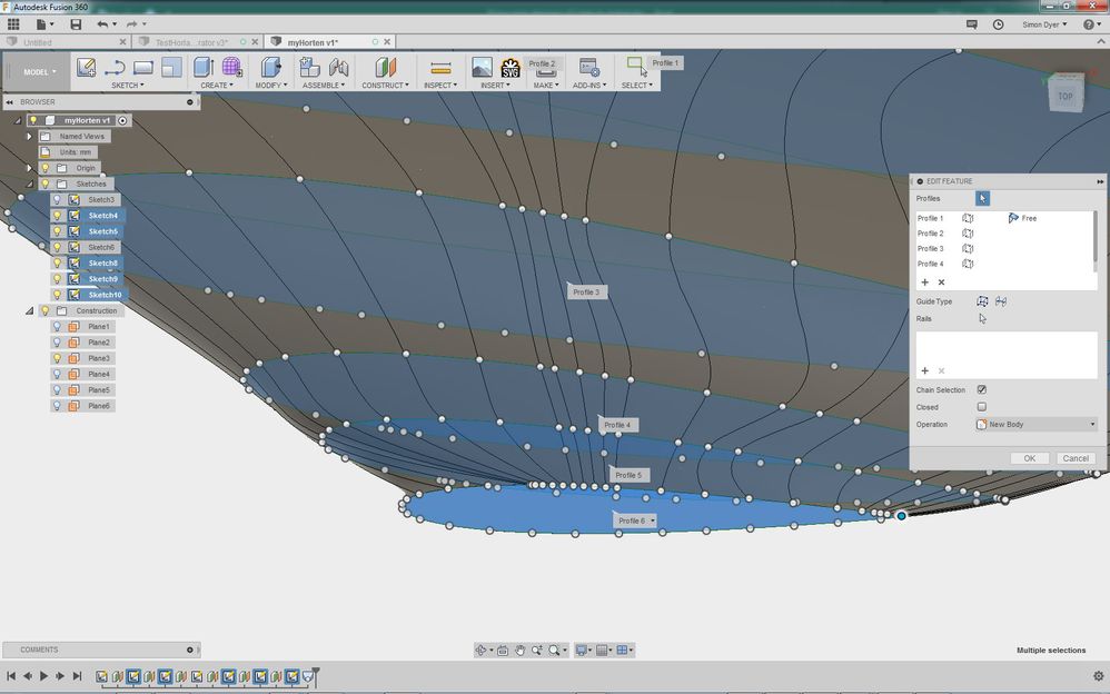

In these pictures you will see my problem easily - the loft through each rib is not aligning up with the points in the sketches.  You can see the sketches are correct when I overlay them - both have 30 points defining the curve starting from the rear, however the loft seems to select diferent points or even creates them magically.
I can move these points manually, but that is long and tedious and inaccurate.  The sketch points are correct and need to be used by the lofter.  See the leading edge this is not right - all twisted around.
Solutions anyone please?

davebYYPCU
Use Fusion Splines to trace your airfoils.
I use four point Spline, for top and bottom.
If using a csv file, use the script to plot the Spline.

Hi @simon.dyer,
@davebYYPCU is correct.  What you are seeing here is what we call "Point Mapping" in Loft.  It looks like your input sketches have many small curves in them.  The modeling kernel in Fusion will create an edge in the model where each curve meets with another.  Each loft section, then, can have many points in it.  Loft tries, then, to map each point on each section to a point on the next section.  Most of the time, it does a pretty good job.  But, if there are many section points, the mapping can be difficult.  You can adjust the mapping by dragging the points around.  If you need, I can record a screencast of how to do this, but basically, it's just click and drag on the white points in the preview.  But, in this case, it will be tedious for you to do this.  There are just too many points.  And, if you don't have the same number of points on each section, the mapping gets difficult anyway.
So, what I would recommend is:  Keep your existing sketches.  In each sketch, select the curves you have, make them construction, and re-trace a single, or at most a couple, of Fusion splines over top of those curves, matching them as closely as possible, and most important, keeping the number of curves in each section the same.  Then, your loft should behave much better.
If you want to share the model, Dave or I, or someone else will be happy to help.

simon.dyer
Whilst both solutions might be okay in the long run, this is an iterative design process - I need to import my wing ribs many times, and loft them. (Maybe actually update the sketches).
The script CSV option might be better if it can connect up to my sketch points (30 in each sketch) - is there a link explaining that process?

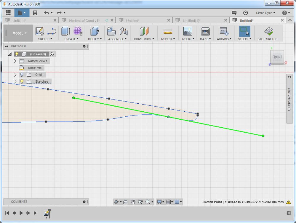

simon.dyer
Okay - solved the import error - I was selecting the wrong export format in Excel - cvs UTF-8, need to use plain csv
Message 9 of 31
simon.dyer
Okay big improvement, but dont understand why importing each sketch as a SVG is so much different to importing as a csv script - clearly it is better, but unsure why loft got twisted in the earlier case.
I didnt do any tracing of the curve - not sure why that step is necessary @davebYYPCU
Now I just need to to figure out why I cant change the control handles on certain points, and how to encourage the loft to follow each sketch, not draw straight through as it has on the TE.

davebYYPCU
Why so many profiles?  Wait till you start adding rails, then you will see how loft can give trouble.
The screencast shows me a few things, you have more than the current sketch visible, I would turn all the others off, (Fusion is trying to help but gets it wrong sometimes)
looks like the low end of the spline handle has been constrained to that other sketch line, you and I know you don't want that but while it's visible Fusion will try to annoy you with it.
(at least while you are editing it.
When you do get to move the handle it also shows me that you have one spline, likely from top of trailing edge to bottom of trailing edge, here 2 works better.
A top one and a bottom one, especially to handle undercamber.
You have 13 visible points on the top of the tip rib, probably the same for the lower side, too many points makes things worse not better.
You have told us about an error in the screenshot, is there a better one, can you attach a test wing for demo purposes?
It looks like an undercamber at the root rib and symmetrical to a degree at the tip, Fusion will transition those two profiles, you are working too hard to make Fusion think.
Could be wrong, would like to help...

davebYYPCU
When you edit sketch, the handle point is not attached to the top Spline section, but I couldn't see what you did to make it snap onto the Spline not long after that, and the top section is acting like the handle end point is a fit point as well, that could be a bug.
Then about the 20 sec mark, you select and place a fix constraint to the end point, which has turned green, and has locked the handle in place from that point on, I didn't see you unfix it.
You can only move the Spline handles when selected and turned lime green.  If by chance the csv import makes the sketch a 3d sketch without telling anyone, then you can only move the handle end points with the Move command.  -  I would try that to establish if it is now a 3d sketch, even if unintentional.

simon.dyer
@davebYYPCU, many thanks for your help.  Ive done a screencast of this final problem with the handles.
I wish I could just convert some of the sections of the spline into polylines.  Then I could have sharp corners.
http://autode.sk/2u19Ms7

jeff_strater
Thanks, @simon.dyer, your comment helped me to figure out what is probably going on with your spline handles.  Because you are not able to just drag them, you probably have (maybe inadvertently) turned your spline into a 3D spline.  Dragging does not work on any 3D sketch geometry, but Move does.  Because you are able to use Move to adjust the handle, this is probably the problem.
No worry, though.  Select the spline, right click, and choose "Move to Sketch Plane" (or something similar, I'm at the airport, and don't have Fusion in front of me).  That should move the entire spline back to the sketch plane, and you should be able to drag the handles again.
At one point in your first video on the handles, while you are trying to debug them, you chose "fix/unfix" on one of the handle points.  I suspect that this had the unintended consequence of fixing a point that was not fixed before.  You will probably need to un-fix that.
Trust me, you do not want to use polyline for this project.  That will get you back into the point mapping problem that you had at the beginning.  Stick with the splines - you are getting close!

davebYYPCU
Oh that is so painful to watch, I wanted to turn it off by 3/4 of it.
All your problem is
is that you have 1 Spline, closed to be a loop, never gunna happen,
any move adjustment effects the curve wider out than just the point you selected
Splines are curves, you can't have a sharp point, unless you join two together, (Top and Bottom splines to make an airfoil)
Please open and review my example file from post 12 above.
Download it, save to hard drive, then in Fusion,
File > New Design from File.
Use light bulbs to examine how close the overlay is.
Honest - I moved 4 handles once to get there, added 2 constraints.  Amongst some other stuff.
As my day unfolds I will try to get a screencast done, would be better if you export your file so I can teach with your data,
File > Export, attach to a post.
