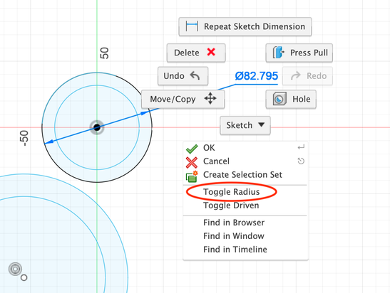

jeff_strater
"I have never developed a full, solid understanding of how Fusion decides whether a constraint is a diameter constraint or a radius constraint, so I just work with whichever it gives me. (The best rubric I've ascertained is that a "whole" circle gets a diameter and a "partial" circle gets a radius, and then, once written, it stays as either diameter or radius"
That is the rule for the default for diameter vs radius.  However, you can always change it after the fact, by right clicking:

Step 1.
Sketch a circle at the Origin and dimension (either as Diameter or right click as Radius as shown by @jeff_strater).
Now sketch a 2-Point Rectangle selecting approximate Points 1 and 2 on the Circle.
Add a Coincident Constraint at Point 3 between the Rectangle corner and the Circle.
The Rectangle is now centered.
Now add the two dimensions to the Rectangle as shown.
The second dimension will prompt you that it isn't really needed and will create a (reference) dimension in parenthesis.
