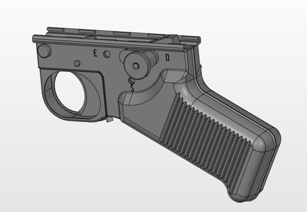

I would like to modify this FG42 model to fit this .22LR Ruger 10/22 action.
Essentially i need to modify the FG42 top receiver to make it wide enough (1.5 inches).
It would be like a clam shell so the internal part of the top receiver would be just a solid shell to hold the entire action in place.
I would then like to get this 3D printed in PLA and cold cast it.
I'm thinking of having to measure out the 10/22 action, save it as a body and then do an intersect to the FG42 upper receiver.
ba.jpgScreen Shot 2016-09-18 at 12.15.14 PM.pngScreen Shot 2016-09-18 at 12.14.00 PM.pngScreen Shot 2016-09-18 at 12.12.40 PM.pngScreen Shot 2016-09-18 at 12.10.31 PM.pngFG42-1folded.JPG

From what i understood your problem is you have a solid model you want to turn into a two piece shell (If that's not the problem, maybe you can explain it better).
To do so you can create a construction plane in the middle of the solid model, use the split body command using this plane so you'll have two solid pieces. Then you can use the shell command to make these solids hollow.
After or before that you can use the scale command to make them bigger or smaller respecting all sizes of the model so it'll fit what you want. All these commands are in "modify" in the model environment. Maybe the presse/pull command can be useful here too.

ah makes sense.  ill try it on a basic part first with the split and shell command
is there a way that i can modify these STL files?
thank you
I think you can import them into fusion and modify them freely.
