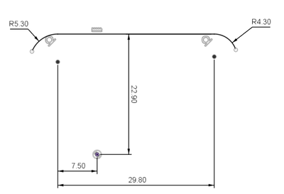

I'm trying to make a clamp for a pipe and I never do a lot of sweeping and lofting and can't really figure out how to do this.  Can anyone give me some suggestions on how to go about this?  Thanks

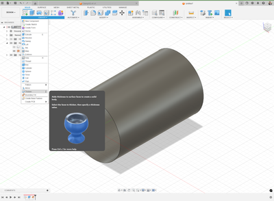

So I am not really sure what it is you are trying to achieve. Why do you need to loft or
sweep? You pretty much have what you need to clamp a pipe as clamping suggests that
you want to secure the pipe to a wall or something. That is unless you want to encapsulate
the pipe as suggested by this picture.
Have you a model for the pipe you want to clamp? One method could be as simple as creating
a surface around the pipe, thickening the surface to create a body and model bolt tags.
No lofts or sweeps required.
Is this what you wanted?
Cheers
Andrew

No sorry, I'm trying to connect between the two.
Message 5 of 14
TheCADWhisperer
@barkster
Why is your Sweep sketch not symmetrical?
Message 6 of 14
barkster
thanks for reply, that's what i'm shooting for but just trying to get more control over the shape,  I've tried adding rails but never likes it and looks horrible when I can get it to work.  I think I'm going about this completely wrong.

Yikes, sure.  I've never know how to dimension a spline like that, now I do... I'm sure there are tons of things I did wrong.
@barkster
We will start out slow with "baby steps" until I am sure techniques are understood and then we will pick up speed.
Start a new file.
Start a new sketch on the Front plane and sketch the horizontal line and two tangent arcs as shown below...
