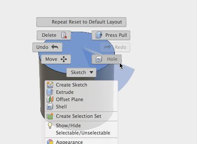

So with one of the flat faces of the cylinder selected, the Hole command should be in the marking menu. Selecting a face is going to give you different options than selecting a Body.
Below is a screenshot of the Hole command in the marking menu.

Sorry about that, looks like my image wasn't added.
