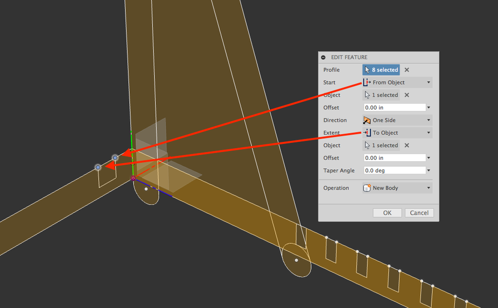

I see how you avoided overlapping lines by creating a U shape with constraints.  Did you use the pattern tool to distribute them?
Next there's an extrusion for the sides but I see no move record.  When you create extrusions from the drawing when how did you place them?
When creating the extrusion it does not have to start at the sketch plane. It can start and stop at an object, the two blue highlighted sketch points in the screenshot.
