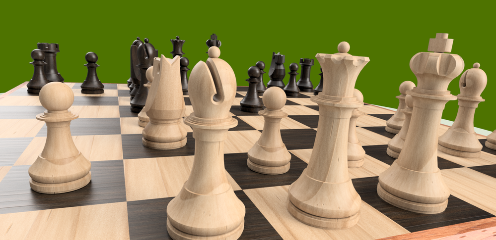

MichaelAubry
That video is out of date anyway. Thank's for the heads up. We added "Solid Wood" a few years ago which is AWESOME.  Just look in your appearances in Fusion:solidwood.jpgChessSet v10.png
