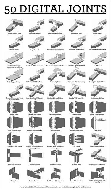

I am trying to lock two different boards so they are stuck as one piece but can be removed later. I am trying to make a sort of slide and lock mechanism between them but I haven't been able to make anything successful that works.
If anyone has any experience with this kind of problem or any ideas, I would appreciate it.

A Rigid Joint will lock two components together and maintain the relationship.

I am talking about in real world terms. I will be trying to print it out
and connecting them and the result hopefully, will be that they will be
pretty interlocked so that it doesn't come apart too easily.
I will be printing out with a CR10 3D printer. If that helps
Message 11 of 16
thanks ive never seen this chart before. I will take a look at this and see if something here will work
Message 12 of 16
lichtzeichenanlage
@Anonymous: Those digital joints are IMHO more related to woodworking and CNC. I would guess, that you could getaway with dovetails more or less all the time.

lichtzeichenanlage
@Anonymous: If you want to have a better resolution of the image, just follow this link

@lichtzeichenanlage
I like the simple dovetail but it doesn't have vertical retention.  So in order to meet the 'pick-up' requirement it would need glue of some kind.  That's where the more complex solution comes in.  Specifically I would consider the shouldered dovetail or double jigsaw to provide locking and vertical support.  I haven't used these joints so a quick prototype would be in order  to confirm.  Thanks for linking to the higher res image.  I was on my phone on the bus and...well...you know, it wasn't optimal.   Opening up the design space a little more there are other options galore.  Hinge type joint with a simple rod to tie the two together.  Plastic cantilever/annular snap fit.  I don't know how thick the two parts are but you could stake in a knurled threaded insert on one panel and use flush head fasteners to tie the two together.
Message 16 of 16
Okay thanks for the help,
I am 3D printing a test piece to see if it will hold and will post my results when it is finished.
I would have liked to glued or just make it a single part but we wanted to make it so it could be in two parts that could be assembled and disassembled quickly.
