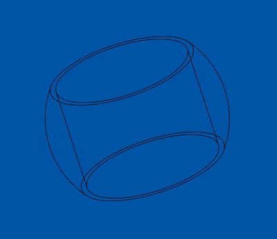

Perhaps (and likely LOL) I am over looking a simple solution on measuring a radius.
In my old CAD when switching to wire frame one could measure every piece of geometry instantly, in Fusion 360 that's not the case and I find it cumbersome to measure a radius quickly.
(PS not comparing Fusion, it's so far ahead in CAD I almost feel sorry for my old one.)
Is there  a quick way to measure a radius?
Thanks much

Show dimension for the Revolve Sketch,
I am presuming it was made in Fusion, and is not a Step File.
the top and bottom rings can be done with the Inspect Tool.
Might help....

Yes modeled in Fusion 350, section in wire frame.
Been away from Fusion 360 for a long time now and don't follow the "Show dimension for the Revolve Sketch,"
davebYYPCU
There is a sketch to Revolve that body, right?  Lofts would be too hard.
click on the name of the sketch in the Browser there is a Show Dimension item.  Turns on all dimensions in that sketch in the modelling window.
There is a Dimension on that arc, right?
If it is unconstrained, you might find it in parameters for that sketch, never tried that.
If not Edit sketch and add it.
Might help....
