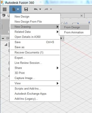

I created a custom deisgn in Fusion 360 for mac.  I modeled nicely and i am trying to share it with a fabricator to get production estimates.  The problem is I can't figure our how to add persistent dimenions to the model.  I can see a 2D in sketch but that is not as useful given the design.  Can anyone tell me of fusion 360 for mac supports the inclusion of persistent measurements/dimensions in model view?

What you should do is, after modelling, produce a drawing for your model (File / New Drawing). In the drawing, you insert all the dimensions you need (as well as other annotations). I agree the drawing framework is rather limiting, as you can only work with 2-D views of your model, but I see no other way to do that.

Secondly, you could create a 2D drawing from your design. This is the option I would do just because it allows you to insert projected views, detailed views (a zoomed in view of sections that may be very small), and cross sectional views to capture interior geometry. This can be found in the file dropdown menu as shown below.
