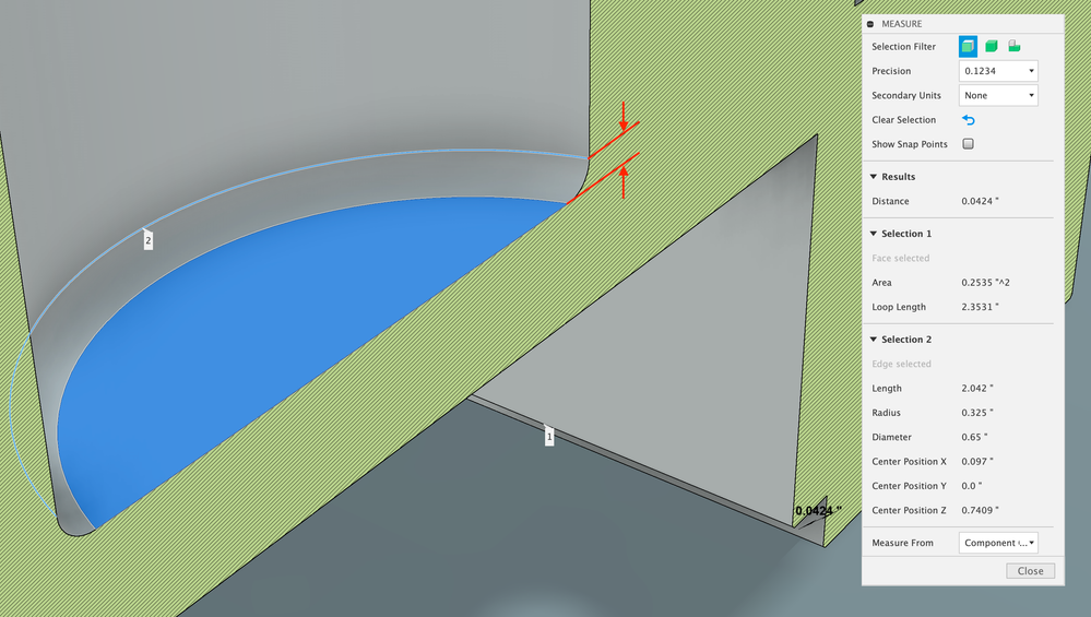

FrodoLoggins
Expected measurement in red:
If I was looking for the measurement given by fusion I would not have clicked on a face.

It's not really a MFG issue, so I'm going to move it over to the Design forum 🙂
Yep, it doesn't return the dimension alignment one would expect. If you click on the two contours you will get a good value:

laughingcreek
the measurement tool in your last pick is returning the value I would expect, ie - the smallest distance in space between 2 edges. there's nothing in the selection set to indicate a direction for the measurement. To get the measurement you're looking for select the planner faces-

HughesTooling
If you select 2 concentric edges Fusion will give you the distance between centres as well as the distance between the curves. What Fusion does not do is treat a planar surface as an infinite plane so you can measure between the flat surface and another object. If you create an offset plane on the bottom surface it would work but that's not how Fusion treats a face, at times it might be useful to have the option though!
