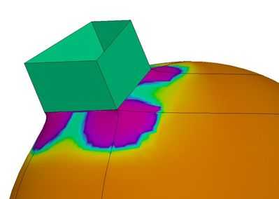

I would like to make have a smooth sphere with a perpendicular extrusion. But I can't seem to obtain an angle without deforming the shape of the sphere:
This is in box mode, the extruded hole is the shape I would like to maintain:
Square hole extrusionSquare hole extrusion
This is the smoothed shape:Smooth shapeSmooth shape
I tried by using crease but this is what I obtain, the spherical shape is ruined near the holeCurvature by using creaseCurvature by using crease
I would like to know if you have any suggestions on how to make such a geometry in the sculpt environment?
Because from my understanding if I go back to model and make the hole, I will not be able to continue to edit in sculpt mode the sphere with the hole.
Ps: I also tried to add more detail (edge) but the sphere is still deformed in proximity of the hole

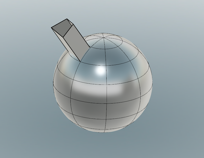

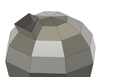

I would like to model a demi sphere, and at the end add thickness as a parameter (the shape resembles a worker hard hat). I need to have those surfaces (extrusion) perpendicular to the spherical shape. I hope the images attached make it a bit more clear.Box view: desired extruded shapeBox view: desired extruded shape
But this I what obtain and I can't seem to make a flat surface perpendicular to the sphere, without deforming all the adjacent area:
Smooth viewSmooth view

Because I would like to be able to take advantage of the polygonal modeling in the sculpt environment (edit form). It allows me to move the position/dimension of the hole (vertices and edges) easily. Since the model is not fixed in dimension/shape it's really important at this stage to be able to adjust it on the fly.
Correct me if i'm wrong, but otherwise to accomplish the above shape I need to do the following: finish the form --> combine the 2 bodies and then stitch the extrusion (box shape) to the sphere, so that I have one surface body?
