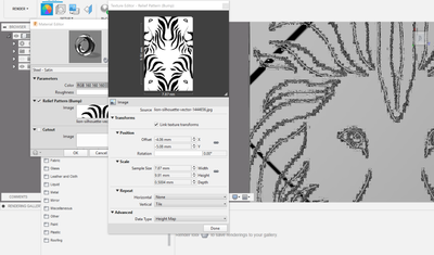

Hey guys so i am currently trying to have an engraving on a metal surface using an image i used the relief pattern and managed to get the image engraved onto the surface however, the engraving looks really rough as though the metal was scraped off i did a render and confirmed it was the case as you can see on the second image . i want the engraving to look smooth as possible i tried playing around with the settings but i really dont know if i can get the effect that i want is there a solution to this? i have also shown the numbers  for my offsets and scaling if that helps thank you in advance

the plane you want to engrave to, is it flat or curvy?
depends on this I can suggest only.

it will be curvy
