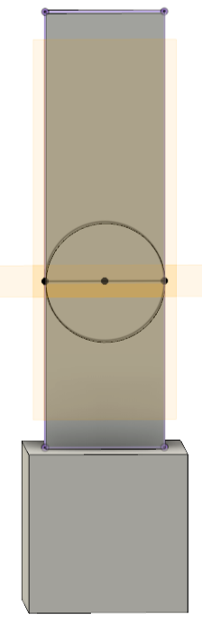

I have a body picture below. I have some construction points, but what I would like to do is make a joint. I tried to rough sketch a side view of what I am picturing below. The part with tang would need relief circles. And the part with the outside flanges would need to be circled so as to spin in the relief. I have tried different ways of splitting, but can't get it. Do I have to make two parts separately? Has anyone done a tutorial on this? With my vocabulary, the searches show two components being made into a joint.

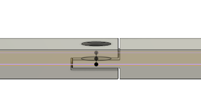

Drill the hole first.
make a side view sketch for one piece - in position,
Offset that chain of lines, the join them together for a sketch shaded profile of the gap.
Extrude > Cut > though All,
make both parts to Component from bodies.
Use as built Joint to > Revolute
Set Joint Limits,
Might help....

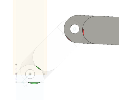

Yes, that made life so much easier. Before the Fillet, I was using sketches and Extrude/Cut.  
I still have just a touch of interference. I will play, but I assume I need to move the hole.
A question, you 6 sides which leaves a straight edge. I Fillet the other but I can't tell if it helps any more.
Maybe back to moving the hole. I am learning now so I am going with the split, but in reality, I may switch to a half lap kind of joint, to make it easier to lock down after positioning. For now, this has been a good learning experience.
