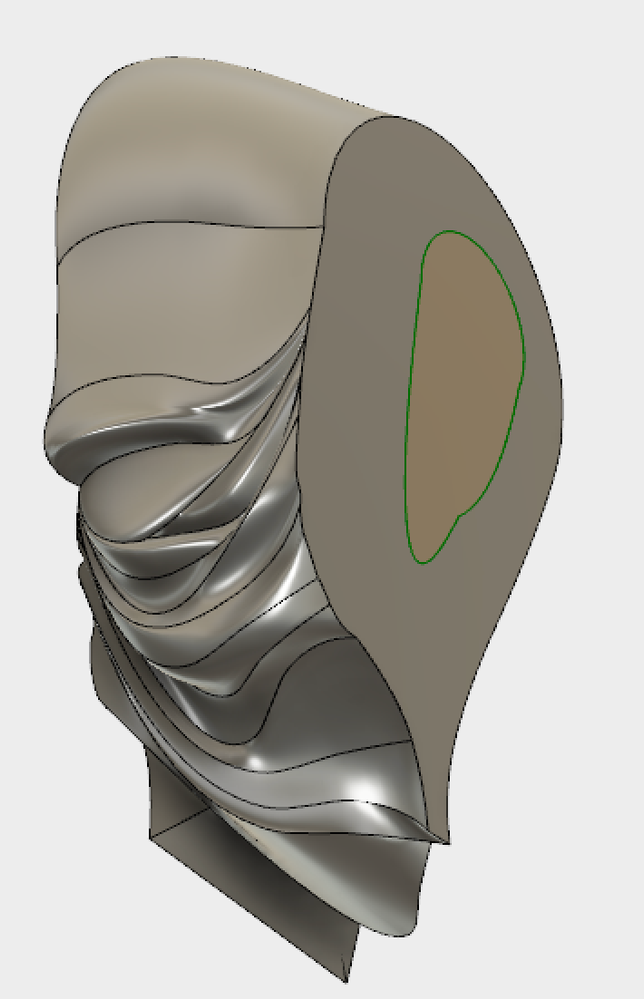

New to Fusion 360 and trying to figure out an issue with lofting!
-So I've imported 5 different svg sketches onto different offset planes, and now I selected them all to loft them together. The problem is I get a "loft would flow in an invalid direction" error. It suggests that I "try adjusting the continuity settings:" and I don't know what those are. As far as I can tell visually there's no issue, unless the shapes are too complicated or something.
I tried lofting with just 2 faces, but nothing changes. Any help would be greatly appreciated, thank you!

Yes, the shapes are too complicated as each profile constitutes a very complex curve. If you can share your design maybe we can find other ways to approach this.

Thank you both for responding! After messing with it a bit more I found I could get 4 out of 5 of the shapes lofted, if I started from the second to smallest one.
And strangely I could also get the smallest and second to smallest ones to loft as well.
But not altogether. In any case, you can probably tell the result of 4 didn't give me exactly what I was looking for. Would somebody be able to recommend another way for me to create a 3D head model using fusion?  Thanks!

The "invalid flow direction", I would have to look at.  But, the strange shapes you are getting are from "point mapping".  Loft has to map points on each profile to points on the next profile in the sequence.  Fusion makes as good of a guess as possible for this mapping, but with complex profiles, that guess can be not what you want.  You can change this, however.  The white points in this image:
are draggable, and can be dragged to get the mapping you want.
If you share your design, I can illustrate with a screencast.

You should always follow @TrippyLighting's recommendations!  In this case, yes, look at that tutorial, and start this in Sculpt mode - that will give you the most flexibility in changing the design as you go.  Trying to do this in the solid environment is probably not going to get great results.
My reason for posting was just to show everyone watching this thread how you can untangle a loft.  Here is a quick screencast of a loft between two of your profiles (I had problems with self-intersecting lofts with some of the others).  As you can tell, this is somewhat painful, and slow:
