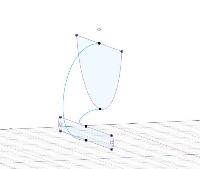

Hi guys,
I can't complete a loft with rails... quite frustrating.
If someone have a solution, that would be nice to share!
Attached what i would like to achieve, with a previous successfull attempt that i can't reproduce....Capture.JPGCapture2.JPG

jeff_strater
The problem with this loft as you have it set up is:  The points on each profile must get matched.  The algorithm gets confused and causes the "wrong" mapping to be applied, and the surface is twisted.
The only way today to untangle this is to add more rails:
Adding just this one rail makes the loft succeed.  If you take this approach, you do get a result:
this model is attached for your information.
