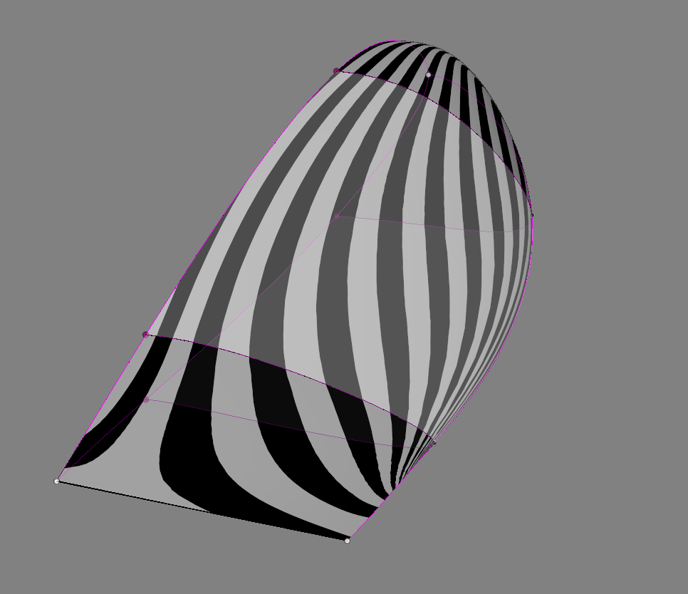

here is a file where I experienced many loft command issues.
the video explains it well.
I am curious what the reasons are and why the loft works that way.

Hi again - sometimes splitting the loft into different features gives a more desirable result with this type of geometry but in this case I still saw the surface intersection:
I think there's something we can improve here but I want to suggest a change in the design (I know that's not ideal) to allow you to continue with your work...
Adding a tiny amount of convexity to the 'End' profile avoids the self-intersection, can you try it out and see what you think? I can't find the file I made but this is an extremely exaggerated view of what I did:
Let me know if that doesn't make sense and I'll upload a file.

cekuhnen
@wilkhui
If the end profile is a triangle the loft works
If the end profile is as previous it fails
this seems not to be very logical to me nor intuitive.
also with a triangle there is no self intersection.
I could split the end profile and the skinned mid section surface into two parts
but then loft cannot offer G1 or G2 along Rails - I long requested and criticized lack in functionality!
So this approach is not even possible in Fusion.
I would say that the loft code in this area really really needs some improvement to make this work better.

I rebuild the design with clean Degree 3 curves
and encounter no self intersections in Alias with the surface tools (sweep rail)
This is what I would expect Fusion to be able to do.

@michallach81 no Fusion cannot because it fails since the beginning to offer surface continuity beyond G0 along rails!
So cross sections cannot be lofted has halfs but only as fulls- so you can split the rails but not split the profile curves.
That's why you cannot model half models in Fusion well but only full models. The loft code even works worse with surfaces
than solids in certain situations.
But besides the lofting short commings, also the sketch engines fails to work well here because the spline tool bends curves
in a crazy way unlike in AI or how I could work with a CV curve.
The screenshot shows how and where the expected linear segment deforms. So you cannot even comfortably sculpt half a profile
with one curve when a certain part has to remain linear meaning you need to make blend curve and split it. but then you have
4 segments not two.
All this should have been a focus for the advanced modeling and sketching tool set but that project got put onto the shelve.
Loft in Fusion vs Alias
Fusion: No G1 G2 along rails but able to loft to a point + point G1 ! pretty Awesome but not so good mesh structure later
Alias: G0 G1 G2 along all profiles and rails
Patch in Fusion vs Alias:
Fusion: G0 G1 G2 for all edges the same way and now eight control - fusion can dome end tubes via draping and trimming but it is a messy surface.
Alias: G0 G1 G2 and implied G1 G2 for each individual edge and weight control
To be fair - Alias square and Fusion patch are not the same tool. I just used it to illustrate what the tools should have in terms of functions.

cekuhnen
here it is
the network is not perfected perfectly smoothed out and I used G1.
To get this into a bezier surface quality one would need even more patches.
but I was only interested in the end of the wing tip
In MOI I also did not get any self-intersection.
