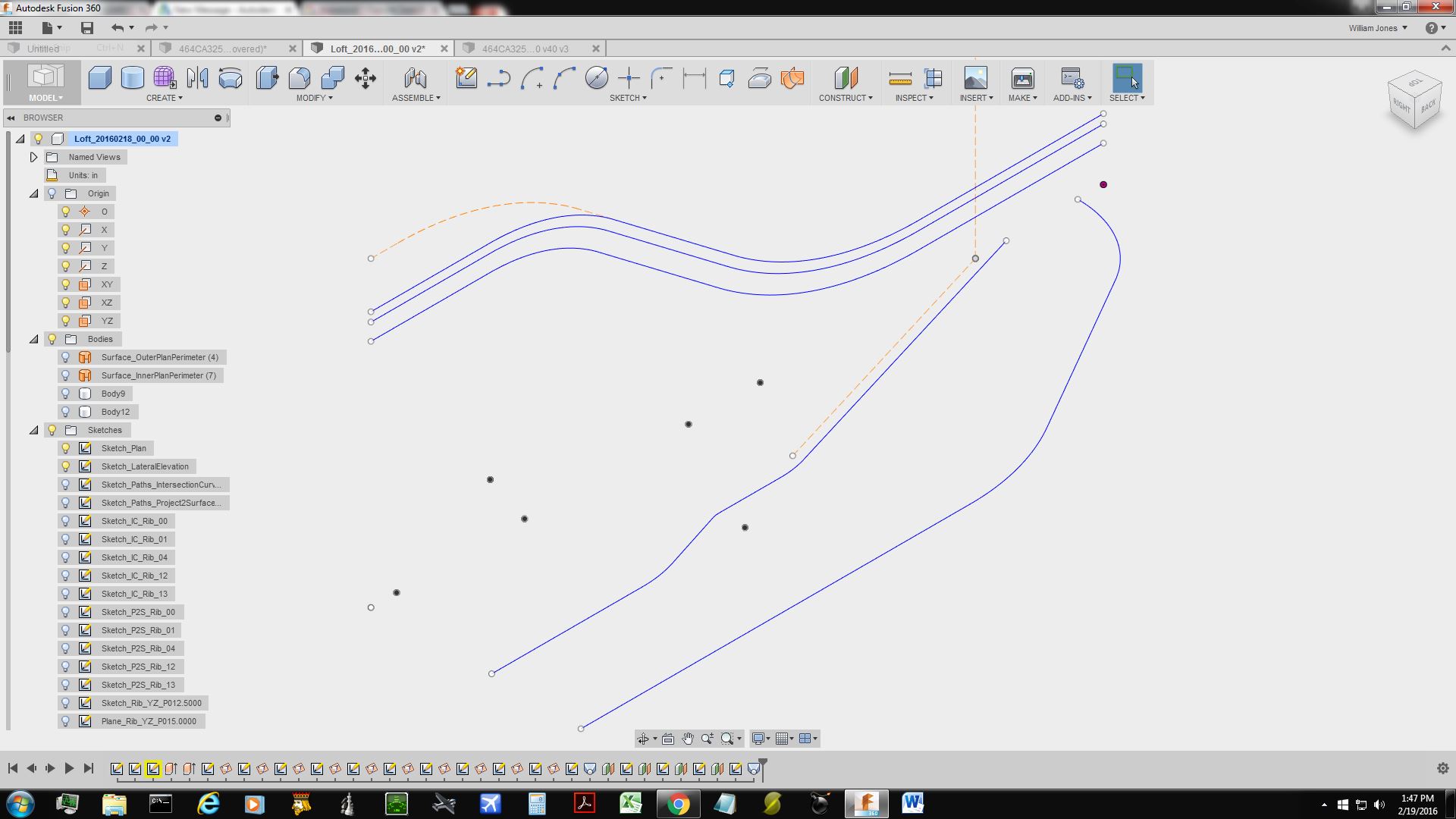

The lavender (?) curves represent the Loft rails along the central beam (nearer curves) and the side frame (farther curves).  These particular curves were developed from repeated Intersection Curve commands which resulted in numerous (apparently meaningless) warnings (signaled by a yellow highlight of the sketch in the timeline).  I also developed similar curves using the Project to Surface command, but these faired no better in subsequent Loft attempts.  The closed sketches for the Loft profiles are also shown.
The Loft rails were developed from these 2-D sketch curves:
The two lower curves are the plan view of the central beam and the side frame while the three upper curves are the lateral elevations of these elements.  Note that the central beam and the side frame share the same top lateral elevations since the joining ribs have horizontal tops.  The other two lateral curves simply reflect the different thicknesses of the ribs from the side frame to the central beam.

Here it was convinced the lower rail did not touch all three profiles.  I know that rail touches, at least to the best of my ability to make it so.  I did an Include 3D Geometry of the needed points or curves in each of the profile sketches.  I got the Coincident constraint to work on each corner of the sketched trapezoid.  Fusion 360 just seems to want something more, or different, or something.

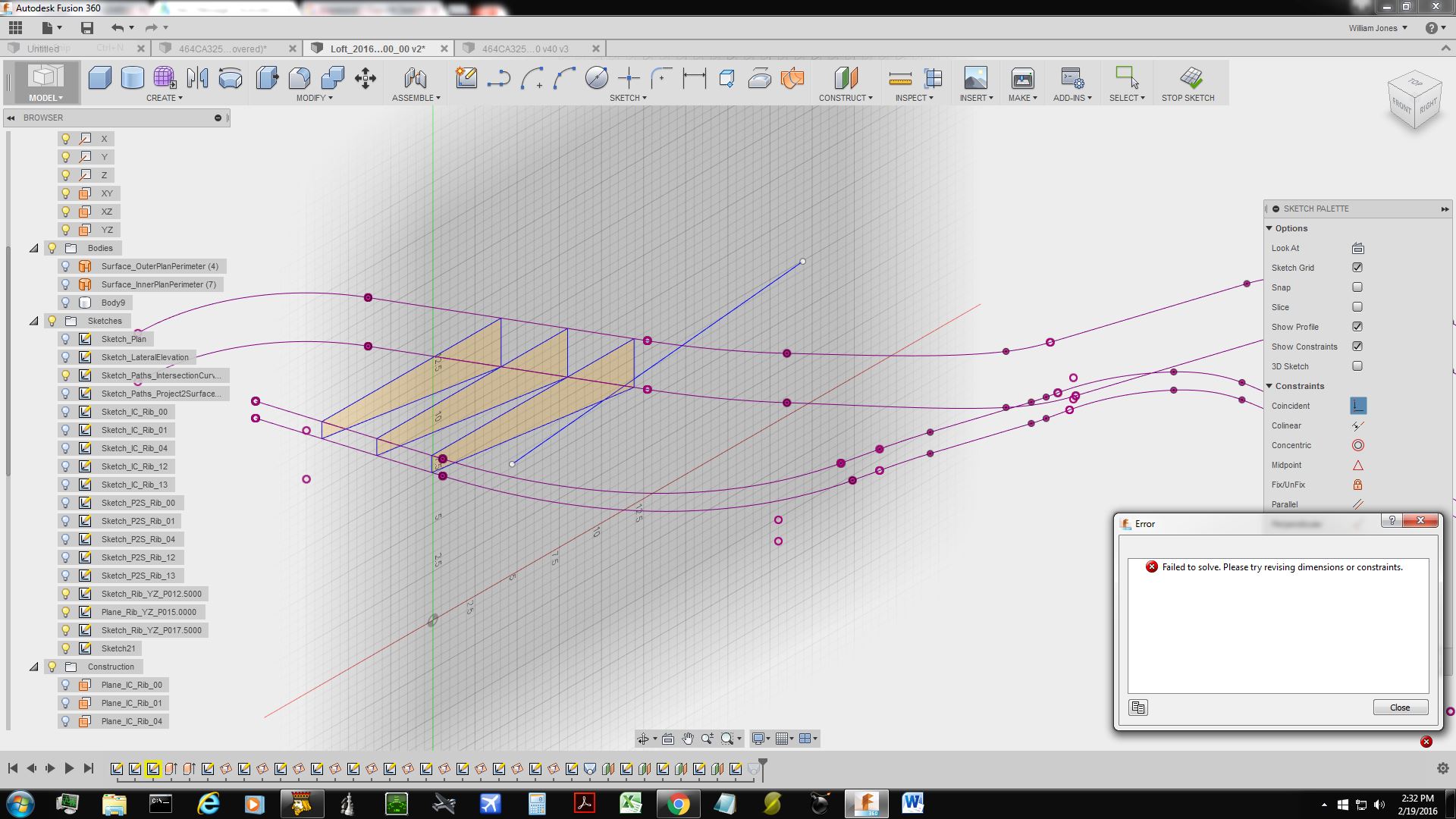

As my final grasp for the brass ring, I tried making a series of evenly space ribs parallel to the YZ plane.  This got as far as Sketch 21:
Here the inner, upper rail has been included as 3D geometry in the sketch, but the Coincident Constraint simply refuses to connect the end point of the line to the curve.  I gave up there and decided to go with the Push/Pull workaround again.
