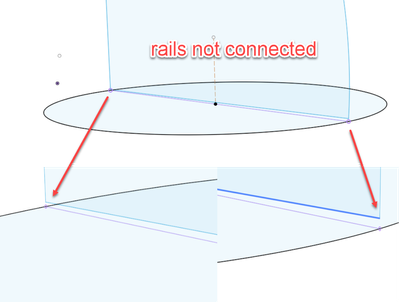

g-andresen
Here is a screenshot showing the missing contact of the rails
