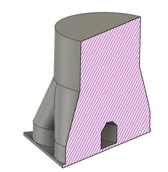

I wanted to make a loft with four wheels to one big one, but I can't.
I did one at a time, cheating the program, turned off each loft before making the next one, then turned them all on and somehow it looks like it, although there are problems as they are highlighted in yellow.
Unfortunately, later on I completely fail to make walls from such a figure.
How can I connect four pipes to one pipe?
Kind regards,
BaGRoS

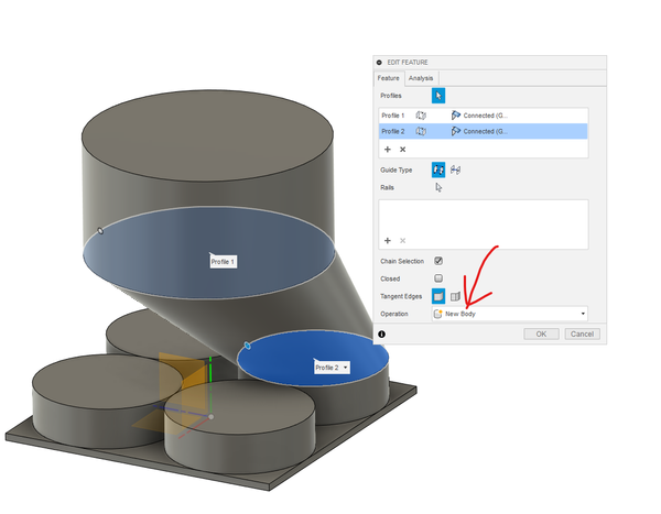

Set all loft options to New Body.
The last method to Combine all the bodies is a good one.
By the way, this part is a pipe, so it must be hollow?
When making a cavity, it is recommended to leave a gap between the pipes so that they do not touch each other, since the Shell command will fail if the lower pipe parts touch each other.
bagros
Yes have to be hollow, I'll use shell but not working with my method.
